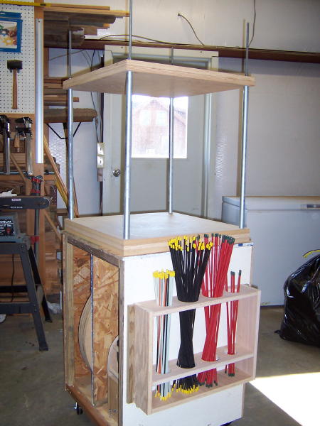

Mine is set up to do all sorts of tasks from brace clamping to top and back attachment clamping so mine is higher than most at 36" total possible deck height. because it is so tall I used 3/4" all thread rods for my posts instead of the typical 3/8". I also mounted it on a 20" heavy duty lazy Susan. one of the best thoughts I have ever had

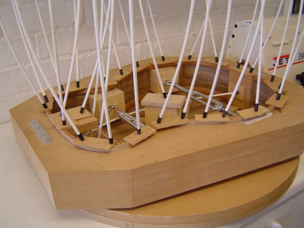

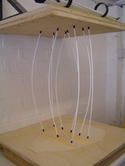

So, you need the length of the go-bars you are going to use for example 24", then the thickness of the radius dish centre say 1/2" (mine are double sided so actually come to about 1 1/4") and also the depth of you usual guitar body say 4". Add together 24 + 1/2 + 4 = 28 1/2". Take off 1" for rod flex gives a distance from top of base to underside of top to be 27 1/2". To brace the plates I sit the dish on a platform of about 4" thickness to get the 1" or so flex in the rods.
My go-bar frame has no side supports being attached to steel brackets on the wall, so I have uninterupted access on three sides, so I had to have the base adjustable. Here's some pictures which may make it clearer:
This shows the top brackets. As you can see for my flat lute tops I replace the dish with a sheet of 18mm ply.

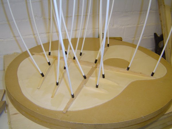

Bracing the top with the dish on it's raised platform.
gluing on the back with the just the dish underneath.

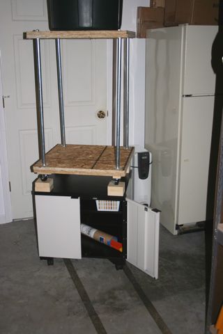

Mine is 32" high from base plate to top plate, and sits on a mobile base that can be rolled into and out of my shop as needed. The mobile base allows me to sit comfortably while using it, and spin the deck as needed for access, etc. The mobile base is a small storage cabinet (flea market find) too.
